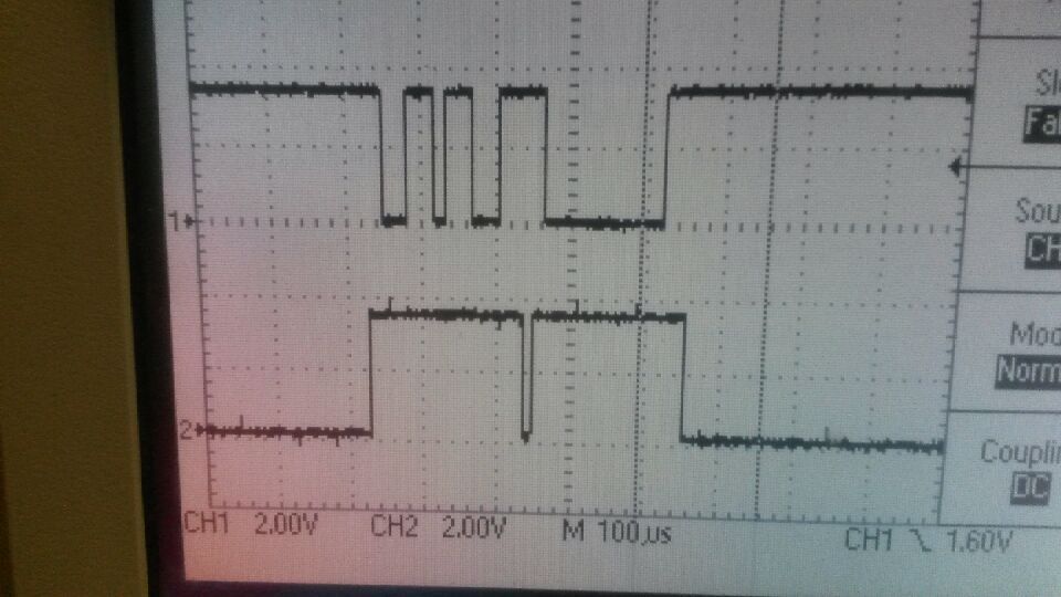

creatron
I modified the imx.c driver and device treers485_direction.jpeg.jpg, and it look like it working fine. The problem is that I could not use the DTE mode, as this swap the RX/TX and CTS/RTS pin direction, thus I left it in the normal DCE mode, and toggle DTR, as this is now an output!!  The reason for this was that I already have a PCB and did not want to do 'cut and past'.  I had to change the device tree as follows
&uart5 {
    pinctrl-names = "default";
    pinctrl-0 = <&pinctrl_uart5>;
    fsl,uart-has-rtscts;
    status = "okay";
pinctrl_uart5: uart5grp {
  fsl,pins = <
      MX6QDL_PAD_KEY_COL1__UART5_TX_DATA    0x1b0b1
      MX6QDL_PAD_KEY_ROW1__UART5_RX_DATA    0x1b0b1
      MX6QDL_PAD_CSI0_DAT18__UART5_RTS_B    0x1b0b1
      MX6QDL_PAD_CSI0_DAT19__UART5_CTS_B    0x1b0b1
The scope trace show the direction change before the first byte and ends when the last byte is transmitted.
This is most obviously not the perfect solution but it worked for me, please feel free to comment and correct my short comings.
