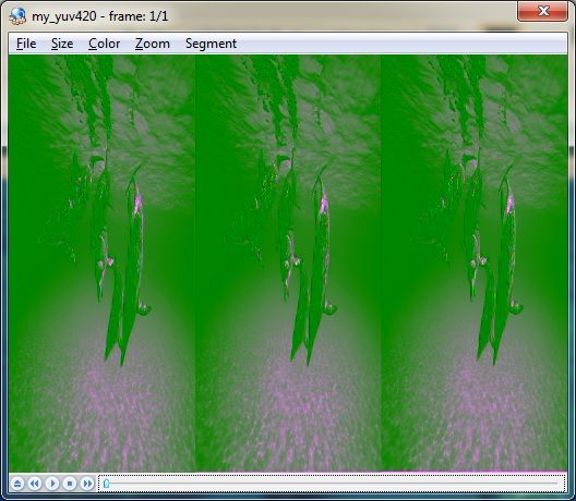

  I'm trying to use IPU to resizing YUV444 image to a smaller YUV420 image on a iMX6 Sabrelite board.
  I'm using sample code from:
https://github.com/rogeriorps/ipu-examples.git
The only thing I have changed is the task structure:
// Input image size and format
task.input.width    = 1024;
task.input.height   = 768;
task.input.format   = v4l2_fourcc('Y', '4', '4', '4');
// Output image size and format
task.output.width   = 512;
task.output.height  = 384;
task.output.format  = v4l2_fourcc('I', '4', '2', '0');
Here is the result I got, can anyone tell me what was wrong?
Thanks.
1,329 Views
timf
OK, I figured out that the original picture in 444P format, not Y444 format. Now I got correct output.
