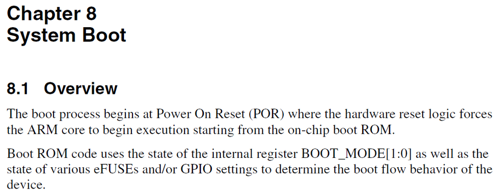

Hi Selcuk,
According with i.MX6 Reference Manual, the selection of the interface to boot is selected by the ROM code, which is automatically executed after a POR. So, if any other reset sends the processor to start the execution after ROM code, the boot interface will not change. Therefore, it is required to restart the execution of the ROM code in order to select a different boot interface.
Hope this will be useful for you
Best regards!
/Carlos
