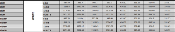

5,274件の閲覧回数
jingpan
Hi @MFurkan ,
Where is this test code? You can put this code in ITCM. This can speed up read/write speed.
This is our test report.
jingpan_0-1701246167625.pngjingpan_0-1701246167625.pngjingpan_1-1701246193044.pngjingpan_1-1701246193044.png
Write is far more faster than read. It's because write operation is pipelined, but read operation must wait till SDRAM feedback.
