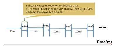

By using the attachment testing program, connect the PC and IMX8 via a two-wire serial port. Run the program "./test /dev/ttymxc2 9600" on the IMX side. On the PC side, set a random string for cyclic transmission with an interval of 10ms, as shown in the figure below.
The attached  testing program on the IMX side receives 20 bytes per second. Due to the slower receiving speed on the IMX side compared to the sending speed on the PC side, the receive buffer on the IMX side quickly becomes full and overflows. At this point, it is found that the application program on the IMX side cannot receive data through ttymxc2.

simon_cai
Hi Sherry
After do testing about 3days,
1,CPU_MODE don't cause cpu stalling error but DMA_MODE does!!!
2,both mode lost data。
both cause frame error.and break error.
Dma_mode will happen overruns error(oe)
We can acpect lost date or frame error or break error, because it doesn't make CPU stalling.
But in dma mode,cpu stalling will happen after 12-24hours。
I think sdma channel stop to copy uart register data ,and cause uart oe error,and then CPU stalling happens。。。i don't know why...
The defers of CPU mode is that cpu never stop to copy data from uart receiver register
We need DMA_MODE in our field situation
We need your help to fix this issue why causing CPU stalling in dmamode
Such great thanks

simon_cai
Hi Sherry
thanks for you quickly feedback.
yes,we didn't use uart flow control because of our field condition.
about this 10ms,  I have additional explaintion.
this 10ms is an interval not a period as shown in the figure below
that is, send 200 bytes to IMX,wait 10ms,send 200 bytes to imx immediately  and wait 10ms send 200 bytes.......
it is not , send 200bytes, wait Sending completed,and then wait 10ms,and send 200bytes, wait Sending completed.....
Suppose, it may fix UART overrun error by using cpu mode uart ,
but it will still happen UART buffer overflow error AS n_tty buffer is full becaue of IMX reading slower than PC sending.
Of course, anyway,we will try CPU_MODE suggestion.
give you feedback soon,thank you Sherry,  Thanks
