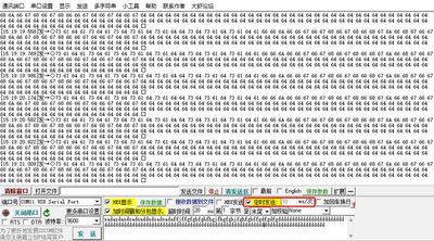

By using the attachment testing program, connect the PC and IMX8 via a two-wire serial port. Run the program "./test /dev/ttymxc2 9600" on the IMX side. On the PC side, set a random string for cyclic transmission with an interval of 10ms, as shown in the figure below.
The attached  testing program on the IMX side receives 20 bytes per second. Due to the slower receiving speed on the IMX side compared to the sending speed on the PC side, the receive buffer on the IMX side quickly becomes full and overflows. At this point, it is found that the application program on the IMX side cannot receive data through ttymxc2.

Hi Sherry
thanks for you quickly feedback.
yes,we didn't use uart flow control because of our field condition.
about this 10ms,  I have additional explaintion.
this 10ms is an interval not a period as shown in the figure below
that is, send 200 bytes to IMX,wait 10ms,send 200 bytes to imx immediately  and wait 10ms send 200 bytes.......
it is not , send 200bytes, wait Sending completed,and then wait 10ms,and send 200bytes, wait Sending completed.....
