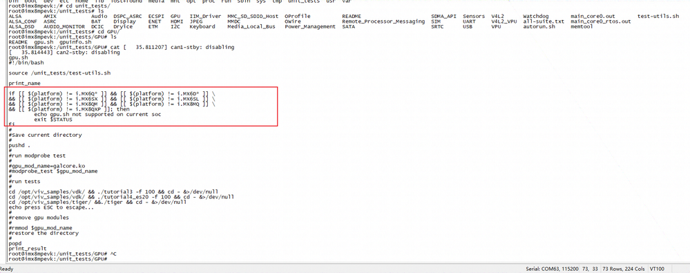

i.mx8M Plus lpddr4 evk board. unit_test script can not run
913 Views
mengfei
Why is it that many test scripts in unit testing cannot be used after writing the root file system in the WIC format provided in the I.MX8M plus development version BSP? Currently using version 5.4.70 of BSP, is this version of BSP not working or all of it not working?
883 Views
Harvey021
Hi @mengfei
I think that the one "echo gpu.sh not supported on current SoC" explaining the issue and your test SoC is i.MX8MP.
Harvey
881 Views
mengfei
i know that my soc is IMX8M plus, The unit test routines in the wic files in the BSP provided on the official website are all from 2018. Will the latest ones not be included
