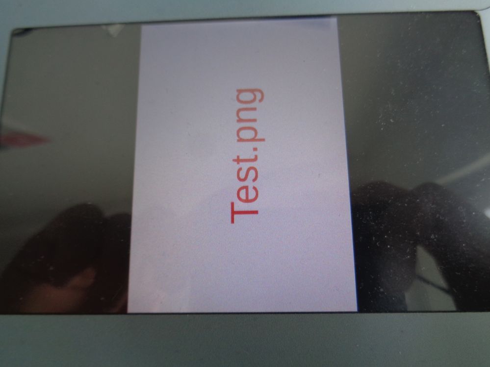

I use I.mx6 with yocto and try to clone/mirror my Display. I have an internal lvds Display and an USB-DVI Adapter (DisplayLink). The Displaylink driver works and after plug it in /dev/fb2 appears. Its possible to copy data in fb2 and it appears on the display. But I want to mirror my lvds screen.

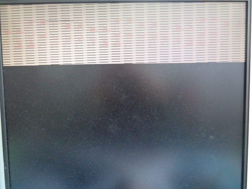

thanks. But it doesn't work. I read that in xorg.conf I have to use vivante for one framebuffer and for the other fbdev (it seems that "vivante" not support two display? :i.mx6q Enable Dual Display of Ubuntu ). But that doesn't work for me.
I would like it to copy one framebuffer to the other (/dev/fb0 to /dev/fb2). But if I do a simple "cat /dev/fb0 > /dev/fb2" (or use my efficient c-code with mmap) the display shows a strange picture (see attachment). Do you know why it shows something like that? Or do you where I can get informations about that?
