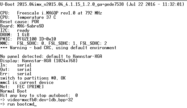

hello I met the problem that the i.mx6qp board can't recognize the HDMI screen.
after entering the command in u-boot the board still says HDMI video is not ready as follows:

Which bsp are you using in your board? Here have you configured the right boot up commands in u-boot command lines? Could you show your u-boot line setting?

thank you for your reply. I am using 4.1.15-1.2.0 BSP. I used the command line which writes "video=mxcfb0:dev=hdmi,1920x1080M@60,if=RGB24" as the one on your official release note. And I don't know how to show the u-boot line setting.

When the u-boot boot up you can press "print", then you can see all the u-boot commands setting.
Here you are using the HDMI screen or only the computer display? And how do you connect your board to the display screen?
