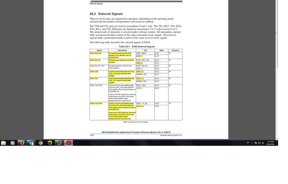

chuanmunei
Hi Every one,
May I seek yours help to share below is correct connection for ESAI/TDM interface for audio path
I have connect this to NXP DSP IC
The BGA pad number/name all is under GPIO for IMX6
regards
Mun Ei
