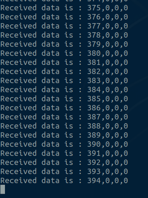

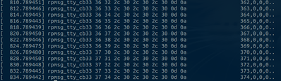

Manuel_Salas
Hello @NZP
I modified a little your code:
for (;;)
        if(rpmsg_send)
            rpmsg_send = 0;
            // convert to string
            len = snprintf(app_buf, sizeof(app_buf), "%d,%d,%d,%d\r\n", voltage++, 0, 0, 0);
            if(len>0 && len<sizeof(app_buf))
                /* Get tx buffer from RPMsg */
                tx_buf = rpmsg_lite_alloc_tx_buffer(my_rpmsg, &size, RL_BLOCK);
                assert(tx_buf);
                /* Copy string to RPMsg tx buffer */
                memcpy(tx_buf, app_buf, len);
                result = rpmsg_lite_send_nocopy(my_rpmsg, my_ept, remote_addr, tx_buf, len);
                if (result != 0)
                    assert(false);
                result = rpmsg_queue_nocopy_free(my_rpmsg, tx_buf);
                if (result != 0)
                    assert(false);
I added:
                if (result != 0)
                    assert(false);
To free the tx buffer, and now you should not have the timeout waiting for a tx buffer rpmsg log.
Logs from dmesg:
Logs from your Linux application:
I modified the voltage variable to increment each iteration.
I can confirm that the cortex M is sending messages to cortex A by the dmesg command, but sometimes trying to read form the ttyRPMSG30 the cortex A freeze for a moment, then work normally and It can read the ttyRPMSG30.
I am still investigating this issue.
Best regards.
Salas.

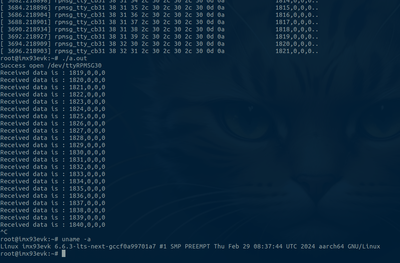

Manuel_Salas
Hello @NZP
I tried with Linux 6.6.3 and it is working well.
Could you please try and let me know if the issue still is happening?
Best regards.
Salas.

NZP
Hi @Manuel_Salas,
While testing I got one observation,
if I do screen /dev/ttyRPMSG30 it is working fine, and port is not freezing, but in c++ application port is still freezing.
4,418件の閲覧回数
