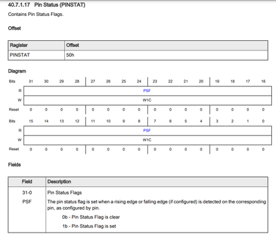

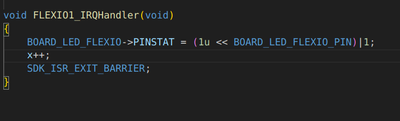

Manuel_Salas
Hello @NZP
I hope you are doing well.
That is happening because the register of PINSTAT is set to 1 in the flag of PIN 24:
You must clear the status flag by software. You can do it as below:
It is working for me.
