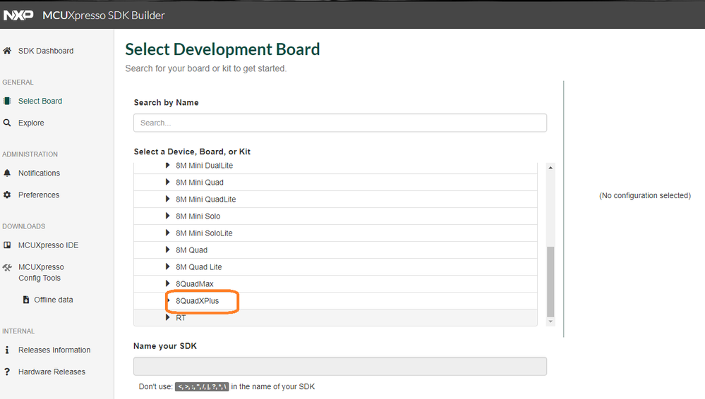

I have looked at and downloaded the MCUXpresso SDK and IDE, but I cannot find any support for the i.MX8X processor. The SDK builder does not include this processor.
5,692 Views
Yuri
  On the Web
https://mcuxpresso.nxp.com/en/select
Yuri.
5,692 Views
amanning
Hello Yuri
Thanks for the info. I did not know that the i.MX8X is the same as 8QuadXPlus. Why can't NXP use the same name everywhere.
I have build  and downloaded a SDK using this settings. The file is called SDK_2.5.2_MIMX8QX6xxxFZ. I am not sure if this is correct for my processor, as the name on the chip is PIMX8UX6AVLFZAB.

Yuri
  please try to follow section 5 (Run a demo using ARM® GCC) of Getting Started with MCUXpresso
SDK for i.MX 8QuadXPlus, Rev. 1, 04/2019.
Yuri.
