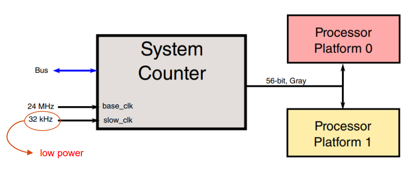

The Generic Timer provides a standardized timer framework for Arm cores. The Generic Timer includes a System Counter and sets of per-core timers.
The System Counter is an always-on device, which provides a fixed frequency incrementing system count. The system count value is broadcast to all the cores in the system, giving the cores a common view of the passage of time. Which is implemented by SCTR.
The System Counter inputs two counter clock sources and outputs a gray coded counter value and interrupt signals (one per compare frame) to the platform’s interrupt controller.
After reset, the System Counter is disabled with count value reset to zero and base frequency selected.
Once the counter is enabled, it will increment the appropriate value on each rising edge of the selected clock.
Best regards.

The crystals we're using for both 24MHz and 32768Hz have a tolerance of +/-20ppm, so I'm surprised we see similar (~5000-15000ppm) drifts on the system counter for our boards.
Is there anything you could advise me to check?
4,335件の閲覧回数
JorgeCas
We usually suggest a tolerance of +/-50ppm or less so, this is ok.
Best regards.
