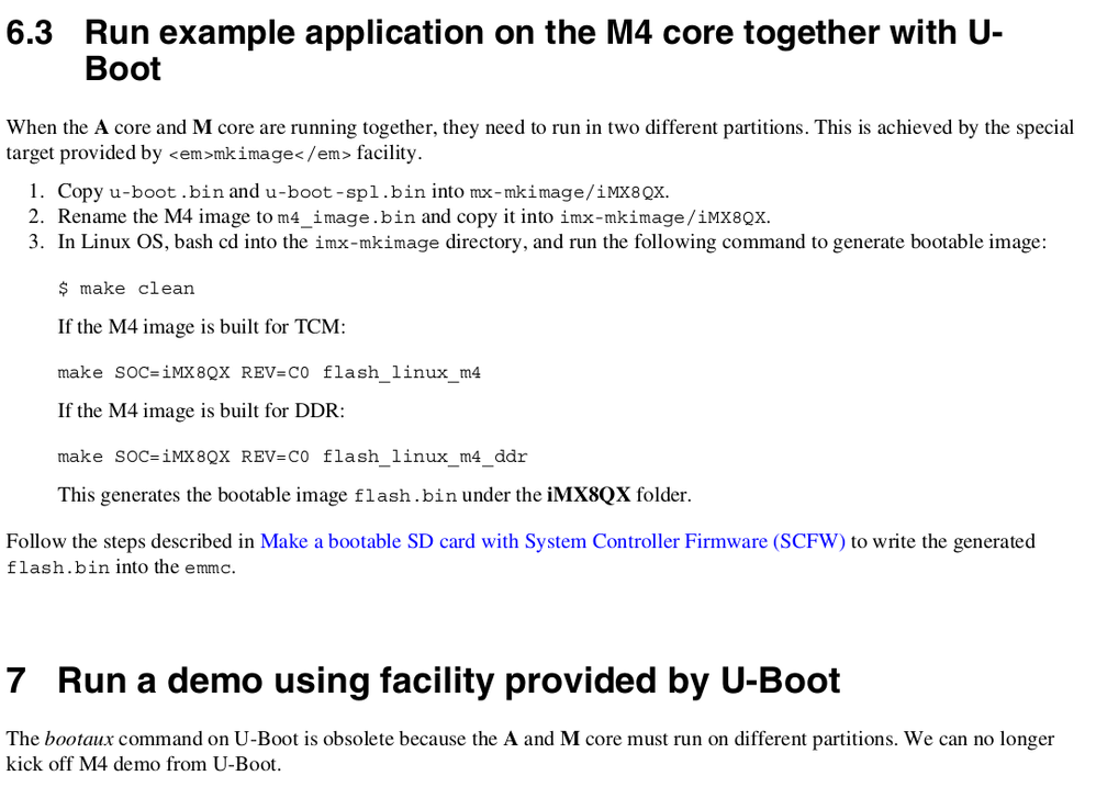

After a skim through the sdk user guide, I found that you can't use the bootaux command to run the m4 demos, It's surprising since I made it work in 5.15 fine.
Screenshot from 2025-03-14 10-19-26.pngScreenshot from 2025-03-14 10-19-26.png
I am trying to build my project, and see if I can run the M4 binary alongside u-boot. It will be run by scfw to my understanding.
I will update you as soon as I get something

roodani
I am not sure what is the cause of the issue,
according to MCUExpresso documentation though, Bootaux is not longer supported because the A and M core must run on different partitions which is not the case when you run it from u-boot.
Surprisingly, this worked just fine using the Linux 5.15 but in 6.6 SCFW detects an error reset the board (Reset cause: SCFW fault reset).
With this info, I decided to launch the m4 binary using the SCFW, which can be achieved according to MCU_expresso docs using the flash_linux_m4 target in the imx_mkimage.
For the sake of trial I managed to use the target flash_regression_linux_m4, which worked just fine, the M4 binary is loaded into memory and u-boot and linux are flashed, However after a power_cycle the M4 isn't launched which is expected because this target only loads in memory for the first time.
The flash_linux_m4 uses spl but it gives an error at the moment :
SPL: failed to boot from all boot devices
### ERROR ### Please RESET the board ###

Fatload for M4 code load is usually used for mscale series M4 boot, A core will handle the load of M4 and start it. It is not suggested to be used in i.MX8/8X, because in 8/8X M core is parallel to A core. Fatload boot will break the relationship of A&M(A core and M core will be in one partition), and violate functions like Linux reboot(SCU will close the whole partition so M4 will be closed as well), board low power mode (SCU will handle this low power mode enter), etc…
For i.MX8QXP/QM, SCU_ROM will handle the load of M4 binary code, and we should inform SCU_ROM if we have M4 binary, in imx-mkimage by soc.mak file. SCU will create a seperate resource partition(generally partition 3) and based on that partition, there would be resource isolation(including memory region) between M core and A core.
To flash your own M4 image, please follow SDK doc "Getting Started with MCUXpresso SDK for MEK-MIMX8QXP" - "Run a demo using imx-mkimage".You need to build a flash.bin file with M4 by imx-mkimage, using "make SOC=iMX8QX REV=C0 flash_linux_m4". Then install the imx_rpmsg_tty.ko file by insmod command.
