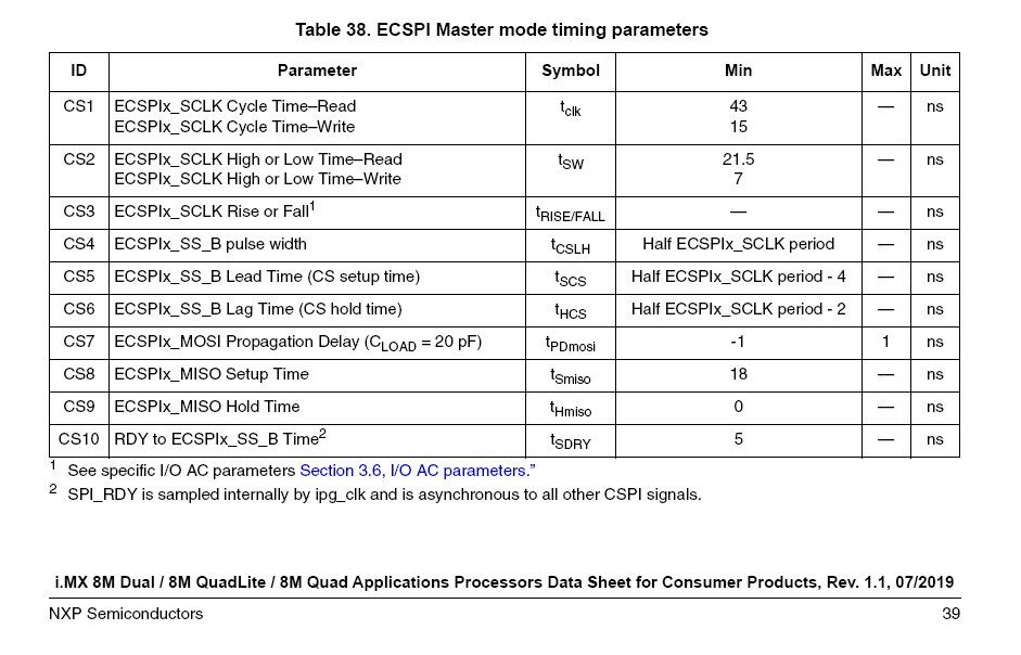

According to i.MX8M Datasheet eCSPI interfaces can operate at maximum data rate of 52Mbit/s. In reality eCSPI clock is limited to 24MHz (checked in /sys/kernel/debug/clk/clk_summary and also using scope). What can be done to supply  higher frequency clock to eCSPI ?
Thanks.

Hi Felix
below ecspi data for i.MX 8M Dual / 8M QuadLite / 8M Quad Applications Processors Data Sheet for Consumer Products
note, i.MX8M is different processor than i.MX8QM
for linux clocks one can look at clk driver :
