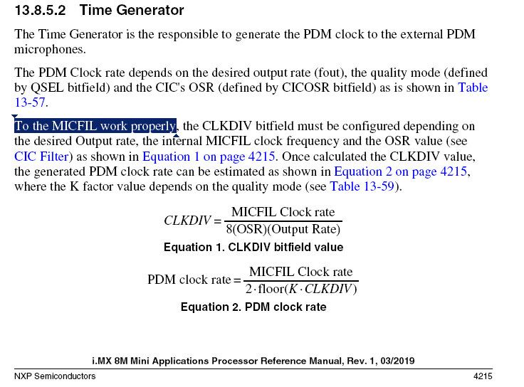

Customer modified the definition of OSR in fsl_micfil.h from 0 to 8 as below to let PDM clock worked at 3.072MHz when recording by 48KHz sampling rate.
#define MICFIL_CTRL2_OSR_DEFAULT  (8 << MICFIL_CTRL2_CICOSR_SHIFT)
Customer also set “MICFIL Quality Select” to 1 and all “CH? Gain” to 15 , but recording SNR becomes to very low.

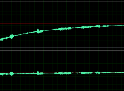

I think I have a similar problem. I'm trying to record 4 PDM mics, but I'm getting a very big DC-offset in the acquired data:
I have enabled DC remover control via alsamixer, and double checked that the applied register value is correct. Unfortunately, the DC offset does not change. Do you have any idea why?

igorpadykov
pdm frequency settings are tightly linked to each other, so one can recheck its
requirements given on
igor

m_c
Senior Contributor I
that’s why change #define MICFIL_CTRL2_OSR_DEFAULT (8 << MICFIL_CTRL2_CICOSR_SHIFT)
to let PDM clock works at 3.072MHz when we record in 48KHz. The SNR is bad.
But If change back #define MICFIL_CTRL2_OSR_DEFAULT (0 << MICFIL_CTRL2_CICOSR_SHIFT)
The PDM clock works at 3.072MHz when we recording in 24KHz. The result is good for us.
