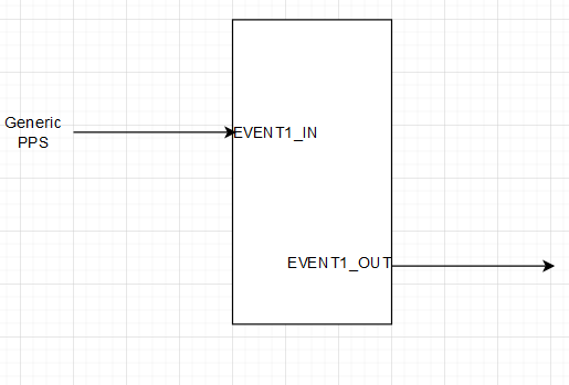

I am pretty new to this, so I'll try to provide as much info as possible. We are using an i.MX8M Mini based board (the Nitrogen8mm) and we are looking into time synchronization using a combination of NTP and PTP.
Essentially, we need to input a PPS signal to discipline the system time and get a PPS output signal so that we can use it to synchronize other components. These two signals must be highly synchronized, which is why we want to make use of the PTP ports. According to the Reference Manual, the  I2C2_SCL and I2C2_SDA can be set for ENET1_1588_EVENT1_IN and ENET1_1588_EVENT1_OUT respectively.
We currently have managed to get the output PPS signal by adding the following lines in the FEC pinctrl of the device tree and disabling all other I2C2 declarations.

Now I'm attempting to get the input and output signal to be synchronized. I tried testing the input signal by using the testptp tool, however, when running the command below to set up PPS input, I get the error PTP_PIN_SETFUNC: Invalid argument.

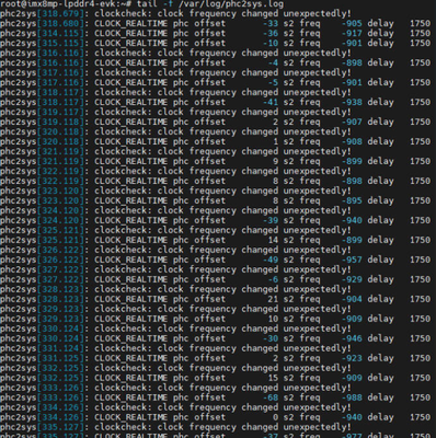

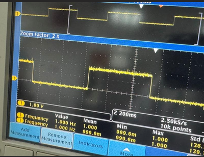

The slave can sync time with master and output pps signal at same time.
Results:
/* SALVE 1 pps output*/
Zhiming

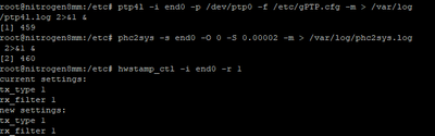

Thank you for getting back to me. I have tried reproducing as closely as possible your tests, however got different results. Sorry if I'm misunderstanding, but the test that you propose consists of the following:
  • having a PTP grandmaster.
  • configuring the IMX to get the time from PTP grandmaster.
  • Reconfiguring system time to match the PHC clock
Doing this will have a PPS output through EVENT0_OUT whose pulses will match with physical seconds and time coming from PTP.
In my current setup there is no PTP grandmaster, at least at this moment. I have a GNSS receiver with a PPS output. We intend to use this PPS output to connect to EVENT1_IN so that it disciplines the physical clock by using ts2phc, making the PPS coming from EVENT1_OUT to be synchronized.
Could you help me clear out if the test you propose is using the EVENT0_IN to get a generic input PPS and you are synchronizing the PPS output?
Here are my results from the test.
I have used EVENT1 since my board does not have physical access to EVENT0_IN, other than that I have used the same configuration values for gPTP.cfg.
Running ptp4l and phc2sys after setting up datetime.
