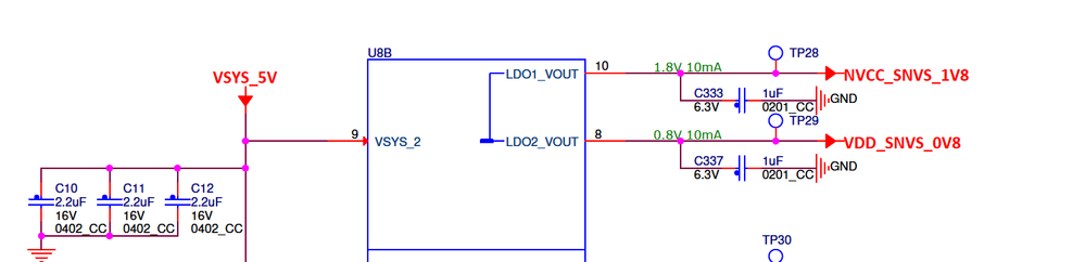

I just wanted to verify but looking at the datasheet for the i.MX8 Mini the RTC cannot be battery or supercap backed up, correct?  If we want to use an RTC with battery backup we will need to add an external RTC in that case.

1. SRTC of i.MX8MM needs 2 voltages.
One is 1.8V, the other is 0.8V.
See schematic of I.MX8MM EVK, please!
2. PMIC(BD71847MWV) on i.MX8M MINI EVK board
Because there is no PAD for LI Coin Cell input on the PMIC, i.MX8M MINI EVK board doesn't support Li battery back for SRTC.
