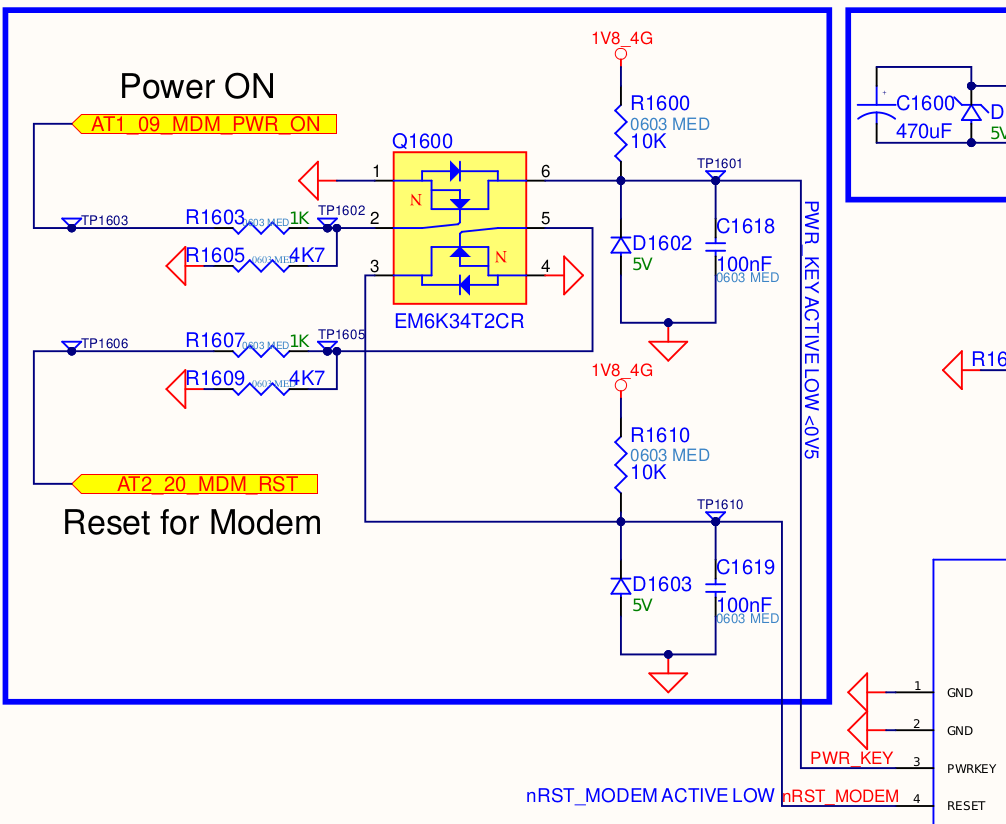

eik3
Hi @Chavira!
Please, find attached the part of the schematic showing how the GPIO1_IO09 (a.k.a. AT1_09_MDM_PWR_ON) is connected to the PWRKEY signal of a 4G module. We are not using an EVK board.
Do you see anything suspicious?

Chavira
Hi @eik3!
You could have the same problem in the next post:
https://community.nxp.com/t5/i-MX-Processors/GPIO-glitch-during-the-bootup-or-power-on-in-IMX8M/m-p/...
I recommend removing R1603 and R1607 and trying to do the measurement at the Test point.
The ground of the 1v8_4g is the same as the imx8m?
If the problem persists please let me know.

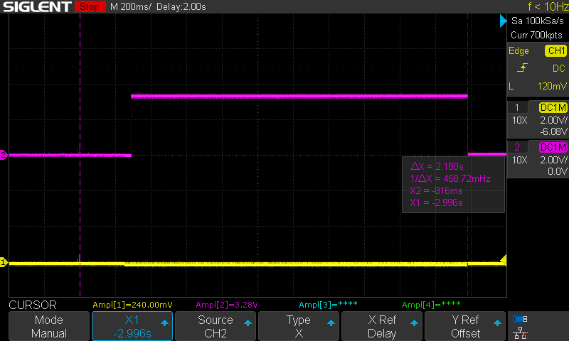

13,623件の閲覧回数
eik3
Hi @Chavira,
I have removed R1603 and the result is the same (see in the attached picture the measurement at Test Point TP1603).
I confirm you that the ground of the 1v8_4g is the same as the i.MX8M.
Best regards.

eik3
Hi @Chavira,
We are using U-boot + Linux.
Apparently, U-boot starts after those 1.8 seconds (the typical "Hit any key to stop autoboot:" countdown appears right after the end of the high-level pulse).
I have attached 3 pictures of the same measurement with different cursors:
  • SDS00003.png --> cursors measuring the 1.892s high-level pulse.
  • SDS00004.png --> cursors measuring the time between the power-on of the board and the end of the high-level pulse.
  • SDS00005.png --> cursors measuring the time between the power-on of the board and the start of the high-level pulse.

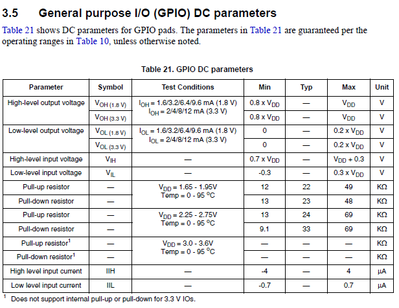

13,234件の閲覧回数
Chavira
Hi @eik3!
I've tried to reproduce this on our EVK, using your device tree, but I don't get the same behavior. The pin stays low while U-Boot boots.
Are you sure that no other connection to that pin is the culprit for pulling the pin high? One way to investigate is to completely remove the pin from the device tree, so it stays default (input).
On the customer's board, is this IO bank supplied with 3V3 or 1V8? In case of 3V3, the GPIO does not support internal pull-up or pull-down resistor. So, an external pull-down resistor is mandatory.
