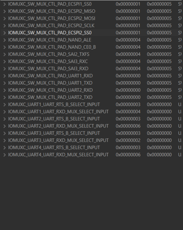

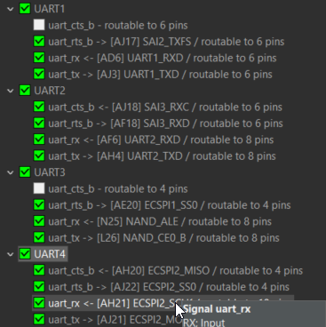

The UM is confusing wrt UART mapping.
I've used the pin mapping tool.
Does this look correct.
Ball
FUNCTION
WRT i.MX8
UART1
AD6
RX
input
AJ3
TX
output
AJ17
RTS
output
UART2
AF6
RXD
input
AH4
TX
output
AF18
RTS
output
AJ18
CTS
input
UART3
N25
RX
input
L26
TX
output
AE20
RTS
output
UART4
AH21
RX
input
AJ21
TX
output
AJ22
RTS
output
AH20
CTS
input

JosephAtNXP
Thank you for your interest in NXP Semiconductor products,
I've configured a project myself and your pinmux doesn't have any conflicts, registers modified match with the reference manual, you can proceed.
