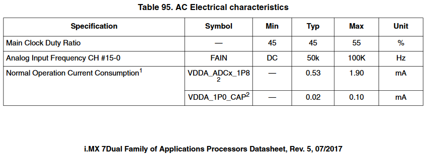

Additionally, if you refer to Table 95 “AC Electrical characteristics” of the i.MX7D datasheet, it is indicated that the maximum Analog Input Frequency is 100KHz:
Hope this will be useful for you.

That is the analog input to the ADC, not the conversion rate.
Table 93. states the maximum Start of conversion clk frequency is 1MHz
