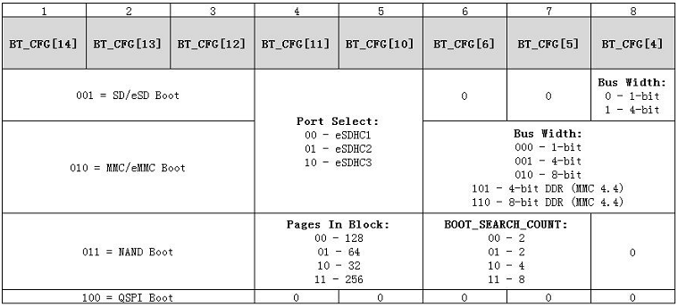

I am having an issue booting an i.MX7 from NAND FLASH.
The MFG tool is being used to program the NAND. The external GPIO boot config is set to NAND. The U-Boot is not booting from the NAND.
The U-Boot code set for the NXP MCIMX7SABRE EVM board does not have NAND fully supported.
The example code mx7dsabresd.c has a block of code with a TODO: NAND in it.

Does anyone know the values for MAKE_CFGVAL entires for NAND?
Or how these values are determined?

Actually, the values of this struct just repeat the values of BT_CFG[19:0] signals for some reason. For regular boot, two upper bytes are always all 0s, for NAND Flash boot the second byte is 0x3y, where y depends on the NAND Flash type according to the table below, the first byte can be left also all 0s or refer to the table below.
Artur

I was able to find some additional information with the help from a friend. The following is my understanding of the interface extension.
It seems that this is a new feature and the documentation for it is still being developed.
This feature provides an interface to allow additional boot media that is not part of the normal fuse or GPIO.
The SRC_GPR10[28] and SRC_GPR9 are part of the feature setup.
The NAND is already part of the normal interface provided by the fuse or GPIO. The BOOT_CFG passed to the hardware during boot were used to define the MAKE_CFGVAL for this extended interface. The NAND boot cfg2 is 0x30, the other values were zero to allow this interface to also use the NAND.
