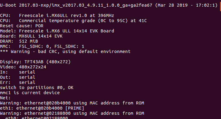

I'm trying to use I.MX6ULL but i have a problem of minicom
When i connect i.mx6ull with PC and run to minicom,
캡처.PNGIt should be marked like this
 333333333.pngBut  it is look like this
I don't know why i can't see like "mmc0 queuing unknown CIS tuple 0x80"
i think Because of this ,  i can't do other commend too
I connected i.mx6ull with PC and run to minicom
After that i tried to run setenv but it was said "-sh : setenv : not found"
I don't know how to fix it
Could you hele me sort my problem out?

Hi Shinbok KIM ,
You are trying to hit the U-Boot commands into device shell which will never work. To get the U-Boot Prompt, Follow the below instructions :
- Press the reset button on you board.
- Press Enter from you keyboard when you see the below print :
Hit any key to stop autoboot:  <x second>
You will get the U-Boot shell now where you can do the things you are doing in bash shell. i.e. change, save.. environment. You can refer to the below link to know more about U-boot commands.
BasicCommandSet < U-Bootdoc < DENX
I understand here that you require to change the environment from the U-Boot shell and not from the bash shell. Right?
