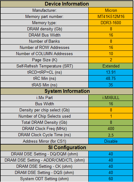

Hi Team
    I am using DDR test tool v3.0. I wanted to run the calibration test for Memory density - 1GB ( Micron - MT41K512M16VRN-107 IT:P) . The problem statement is I don't have script file to be loaded for this configuration. can any one provide proper script file for below configuration:
- 1GB memory density
- DDR operating freq is 400 MHz
- DRAM bus width is 16
Please provide the script file .inc for me to run the calibration.

did you have a linux running with die MT41K512M16VRN?
We tried it but the kernel didnt start. Only if wie set the DRAM size to 800MB the Kernel start.

viralvasa
Thank You very much Yuri, This setting worked for me.

viralvasa
Hi Yuri
  Thank you very much for reply.
  I already have this tool, but I need to load a script file for 1GB memory. to do calibration.
  is my understanding right that script file is needed for different density memory ? current tool has script file of max 512MB only.  can you please let me know on this issue

Yuri
   Please try the following settings.
Yuri.

Yuri
   Customers can use the following tool:
“i.MX6ULL_DDR3_Script_Aid”
https://community.nxp.com/docs/DOC-333791
