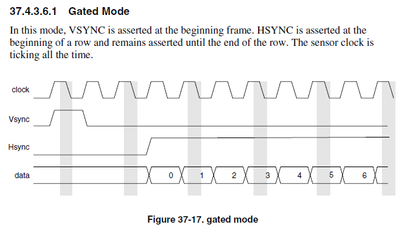

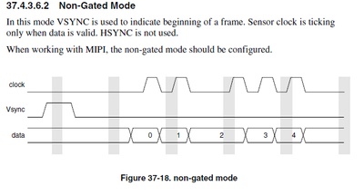

Additional confusion arises from the IMXQRM.pdf, consider figure 37-18
This agrees with the so-called "non-gated mode" described in CSI_Timing.pdf.
However, figure 37-17
is called "JPEG mode" in CSI_Timing.pdf.
Where does CSI_Timing.pdf come from, and are those timings to be trusted?
