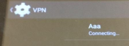

I have a question about VPN with i.MX6Q Android BSP.
Our partner checked the work of VPN, but it did not work well with a setting even though Android BSP supports VPN according to i.MX6 D/Q and i.MX6 DL/S Android JB4.2.2_1.0.0-GA release.
Please see the detail as below.
[Board]
MCIMX6Q-SDP
[BSP]
android_jb4.2.2_1.1.0-ga or android_jb4.3_1.1.0
[Procedure]
1. Launch Settings and select "Security" on android BSP after boot.
2. Select "Screen lock", and set "PIN".
3. Select "More..." in "WIRELESS & NETWORKS".
4. Select "VPN".
5. Tap "+" on upper right of screen.
6. Select type as "L2TP/IPSec PSK".
7. Input Name, Server address, IPSec pre-shared key, and tap "Save".
8. Connect VPN set in process No.7.
[Result]
If select L2TP/IPSec PSK in process No.6, it did not work well.
But if select PPTP, it worked well.
[Question]
Q1. Does i.MX6 Android BSP (jb4.x) support VPN with "L2TP/IPsec"?
Q2. If the answer to Q1 is YES, did Freescale confirm whether it works well?
Q3. If the answer to Q1 is NO, do you have a plan to support VPN with "L2TP/IPsec" in following revision (KitKat BSP)?
Q4. Does i.MX6 Android BSP (jb4.x) support VPN with "IPSec Xauth xxx" and "IPSec Hybrid RSA"?

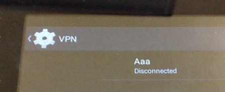

Hi CarlosCasillas,
If it does NOT work, the connection status in "Settings -> WIRELESS & NETWORKS -> More... -> VPN" as following images.
If it works properly, the connection status is changed to "Connected" instead of "Disconnected" or "Connecting".
Satoshi Shimoda
