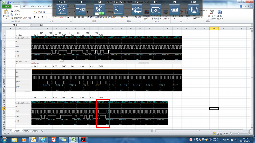

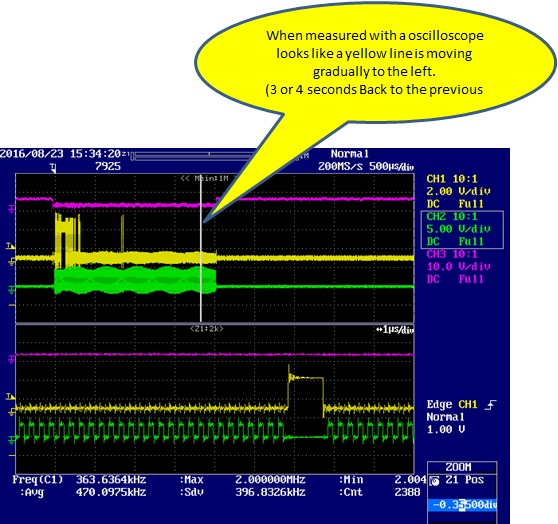

In i.MX6D, I use the DMA in the Master mode of ECSPI is transmitting of 1008Byte
But, SCLK is stopped during transmission as attachments (remains Low),
Phenomenon during which SIMO is High will occur about two times.
Timing that occurs will continue to shift little by little not fixed.
What you may be considered, such as something cause
Best.
T.Takahashi
Pink :SS
Yellow:SIN
Green:SCK

takashitakahash
Dear igor.
Thank you for support.
This problem has been resolved.
Cause was found.
The 1008Byte = 8064bit = 0x1F80bit as trying to set in BURST_LENGTH,
BURST_LENGTH because of 12bit, like lower 12bit worth of 0xF80 = 496Byte has been specified.
Therefore burst transfer for each 496Byte had become the behavior to stop.

takashitakahash
Dear igor san,
According to the log,
- 496 clock (62Byte) SCLK for each transmission is stopped four clocks.
· SCLK during the stop, MOSI is about 0.5 clocks Low next, and then about 3.5 clocks High
Become.
· SCLK after the stop, communication is resumed normally.
It looks like phenomenon is repeated that.
Would you please advice this issues?
Thank you,
Best Regards.
T.Takahashi
