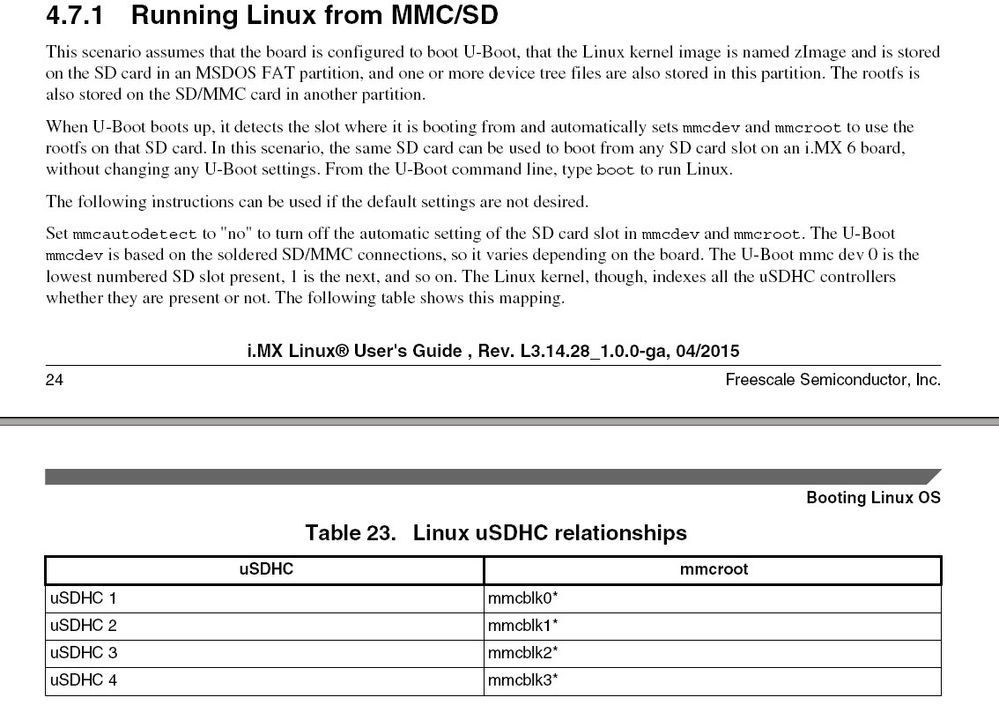

U-Boot > pri
baudrate=115200
bootargs_base=setenv bootargs console=ttymxc0,115200
bootargs_mmc=setenv bootargs ${bootargs} root=/dev/mmcblk0p1 rootwait rw
bootargs_nfs=setenv bootargs ${bootargs} root=/dev/nfs ip=${ipaddr} nfsroot=${serverip}:${nfsroot},v3,tcp
bootcmd=run bootcmd_mmc
bootcmd_mfg=run mfgtool_args;bootz ${loadaddr} ${initrd_addr} ${fdt_addr};
bootcmd_mmc=run bootargs_base bootargs_mmc;mmc dev 2;mmc read ${loadaddr} 0x800 0x4000;mmc read ${fdt_addr} 0x5000 0x800;bootm ${loadaddr} - ${fdt_addr}

U-Boot > run bootcmd_mmc
mmc2(part 0) is current device
MMC read: dev # 2, block # 2048, count 16384 ... 16384 blocks read: OK
MMC read: dev # 2, block # 20480, count 2048 ... 2048 blocks read: OK

Kernel command line: console=ttymxc0,115200 root=/dev/mmcblk0p1 rootwait rw

According to log info is MMC3, somewhat less understood is that MFG mmcblk0p1 tools are issued by the district and the boot becomes MMC3
root=/dev/mmcblk3p1 rootwait rw->Normal boot
1,910 Views
igorpadykov
Hi haibo
numbering is explained in i.MX_Linux_User's_Guide p.24
from L3.14.28_1.0.0_iMX6QDLS_BUNDLE
igor
1,910 Views
haibohe
Thank you for your solution checked
1,910 Views
