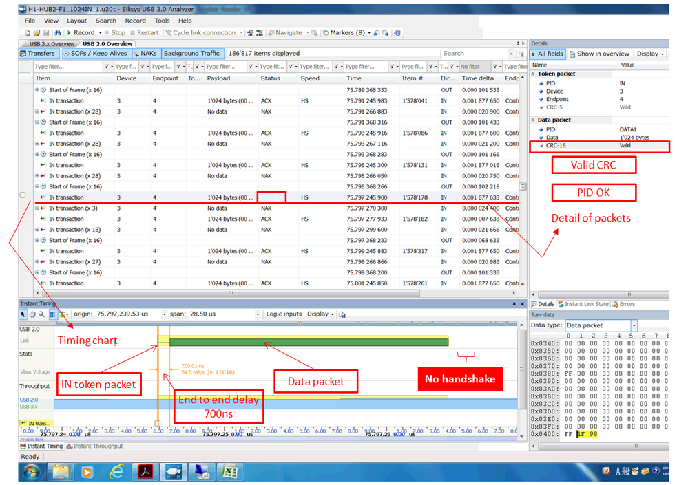

We checked i.MX6 USB communication between two Sabre-SD boards as following.
MCIMX6Q-SDB/host----HUB1----HUB2---MCIMX6Q-SDB/device(otg)
Unfortunately host controller didn't respond immediately after IN token packet transaction ended.
Please see marked "No handshake" in screen capture of USB analyzer.

Can you give us some advise to debug such issue smartly?
Is there any particular conditions or states of i.MX6 USB host controller which cause no respond?
Is there any errata related this issue?

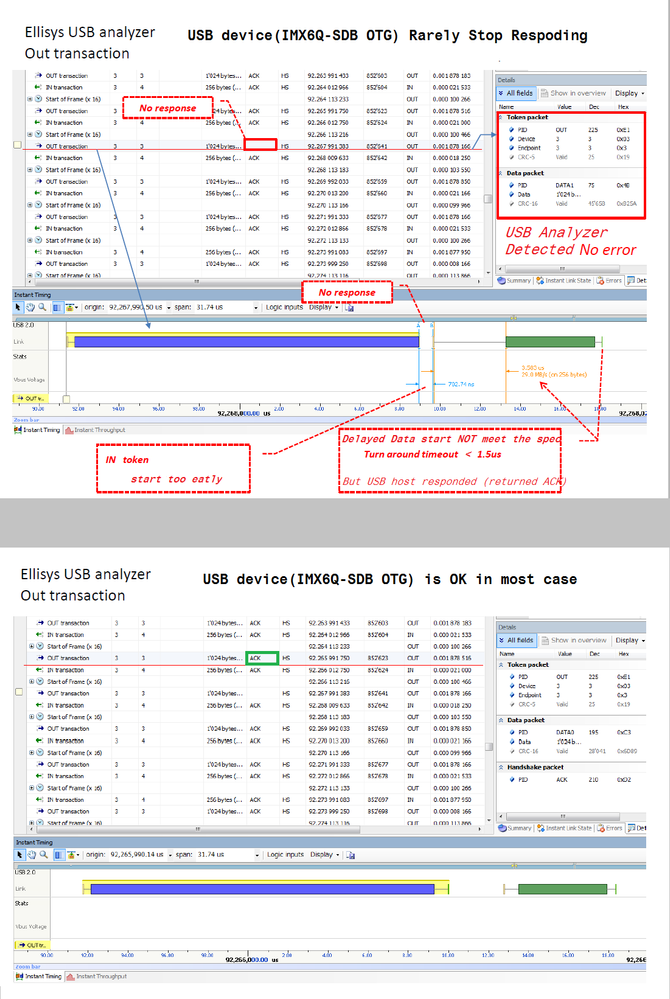

Let me update my status and questions as following.
Previous questions focused on USB host response but USB device didn't respond neither.
After all, ACK is rarely missing in both IN and OUT transactions as following,
if more than 2 hub relayed and datasize=1024 byte.
IMX6Q-SDB       IN       IMX6Q-SDB
[USB Host]<--[HUB]<--[HUB]<--[USB Device]
           ACK -->
IMX6Q-SDB       OUT      IMX6Q-SDB
[USB Host]-->[HUB]-->[HUB]-->[USB Device]
                                                <-- ACK
Questions:
(1) Is there any reasons USB device suddenly didn't respond even USB analyzer did n't detect any errors.
(2) Why does USB host start IN token so early around 702ns after missing ACK(no response)?
(3) Why does USB host respond even Turn around timeout(from IN token to data packet start) over the spec (<1.5us) which measured 3.583us?
I worry about (2)&(3) don't meet the USB spec.

BTW, We confirmed qTD status bits then found bit3(XactErr:Transaction Error) set. (See below)
It was weird status because USB analyzer has never been reported transaction errors such as timeout, PID or CRC errors.
(Q) Is there any other sort of transaction errors?  (How can we determine the sort of errors?)
(Q) Why our usb analyzer couldn't recognize this error?  (Is there any non-standard configurations for the i.MX6 USBHC?)

Q. Is there any other sort of transaction errors?
A. No.
Q. Is there any non-standard configurations for the i.MX6 USBHC?
A. No.
