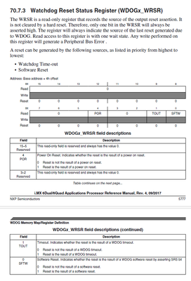

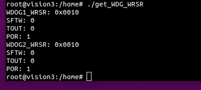

I can read the registers WDOGx_WRSR ( adresses 20B_C004 and 20C_0002).
See In attached files, the C code
As I don't know which one of the watchdog is used by Linux, I checked both.
The return of my console is :
It 's not what I was especting.
POR is true in most of case.
But I voluntary triggered the watchdog, by a python code, which interacts directly with Linux watchdog driver. (also in attached file). So I expected one the TOUT bit should be to 1/ true.
My question now is, does this register is reliable ?
If not, I think, according IMX6 datasheet, there is no other way to know if Watchdog was triggered (Because the watchdog's counter was not periodicaly reset, which means In my real use case, a freeze)

Can you explain me, in which conditions the bit TOUT of the register WDGx_WRSR is set to TRUE ?

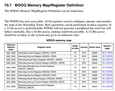

Thanks to an other post (imx6 Watchdog - NXP Community), I got complete datasheet 'file name" and was able to download it from this link :
 MCIMX6D5EZK08AD MCIMX6D7CZK08AD MCIMX6D7CVT08AE MCIMX6D5EYM12AC MCIMX6D5EYM12AD MCIMX6D7CZK08AE Data...
I have now the adresses :
Then, all are registrer are described.
I will finally know if yes or no, a bit meromizes if the watchdog was triggered.
