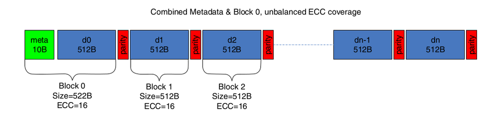

I am trying to configure u-boot and the partition layout for our hardware.  We plan to boot from a 2k page size, 128k block size 512MB SLC NAND flash.  Looking at the configuration files for Freescale's i.MX6 development boards, they seem to allocate a very large (16-20MB) partition to contain the boot structures and u-boot.  Also, u-boot's environment storage seems to be located at some seemingly arbitrary offset inside that partition.  Comments inside the board's u-boot config.h header reference kobs-ng, but searching the kobs-ng source code didn't really explain the layout very well.  Could someone please summarize where all of the boot structures, u-boot, and the u-boot environment are stored inside the partition?  What is the minimum viable size for a boot partition given the above flash parameters and a u-boot image that can fit inside 3 blocks?

But you should notice the data in each page have a layout because the gmpi is using ecc and the BCH module need
a layout based on the page size and the syndrome that layout is choose by the gmpi driver and MTD layer.
So at the end if you do a raw read you are going to have something like this:
Where the FCB ,DBBT and in general all data is going to be split in each page with intermixed ecc.
And the ROM expect that layout when is read because the FCB have it.
The environment in u-boot as you mention is a hard coded offset after u-boot offset and only ensures nothing could overwrite it. That could be changed in the board config file.
Related to you question about minimum that need to be calculated knowing the nand geometry and also the layout to be used. You could change those if you like. Also is possible to erase or not write copies of those structures but if something goes wrong with a block in your nand and that block is where the boot structures are even when the boot data is ok are not to be able to boot.
