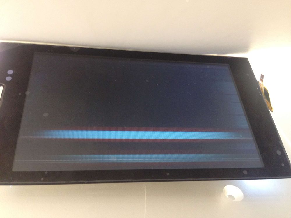

I'm trying to add a mipi-dsi display to our custom board (Ixora based, with mipi-dsi connector available), using Apalis iMX6 Dual. The display (http://www.cct.com.my/pdf/TFT-color-spec2017/4.0%20-T400A01X00_REV2/4.0%20-T400A01X00_REV2.pdf) uses a Sitronix ST7701 controller ( http://www.startek-lcd.com/res/starteklcd/pdres/201705/20170512144242904.pdf ).
No modifications are made in u-boot. The modification in the imx6qdl-apalis-ixora-v1.1_custom.dtsi file, to allow mipi-dsi are:
  1. &mxcfb1 {
  2. disp_dev = "mipi_dsi";
  3. interface_pix_fmt = "RGB24";
  4. mode_str ="ST7701-WVGA";
  5. default_bpp = <24>;
  6. status = "okay";
  7. };
  8. &mipi_dsi {
  9. dev_id = <0>;
  10. disp_id = <1>;
  11. lcd_panel = "ST7701-WVGA";
  12. pinctrl-names = "default";
  13. pinctrl-0 = <&pinctrl_mipi_dsi_reset>;
  14. reset-gpios = <&gpio2 1 GPIO_ACTIVE_LOW>;
  15. reset-delay-us = <120000>;
  16. #reset-cells = <0>;
  17. status = "okay";
  18. };

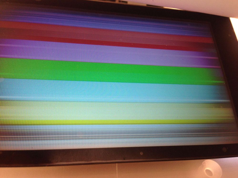

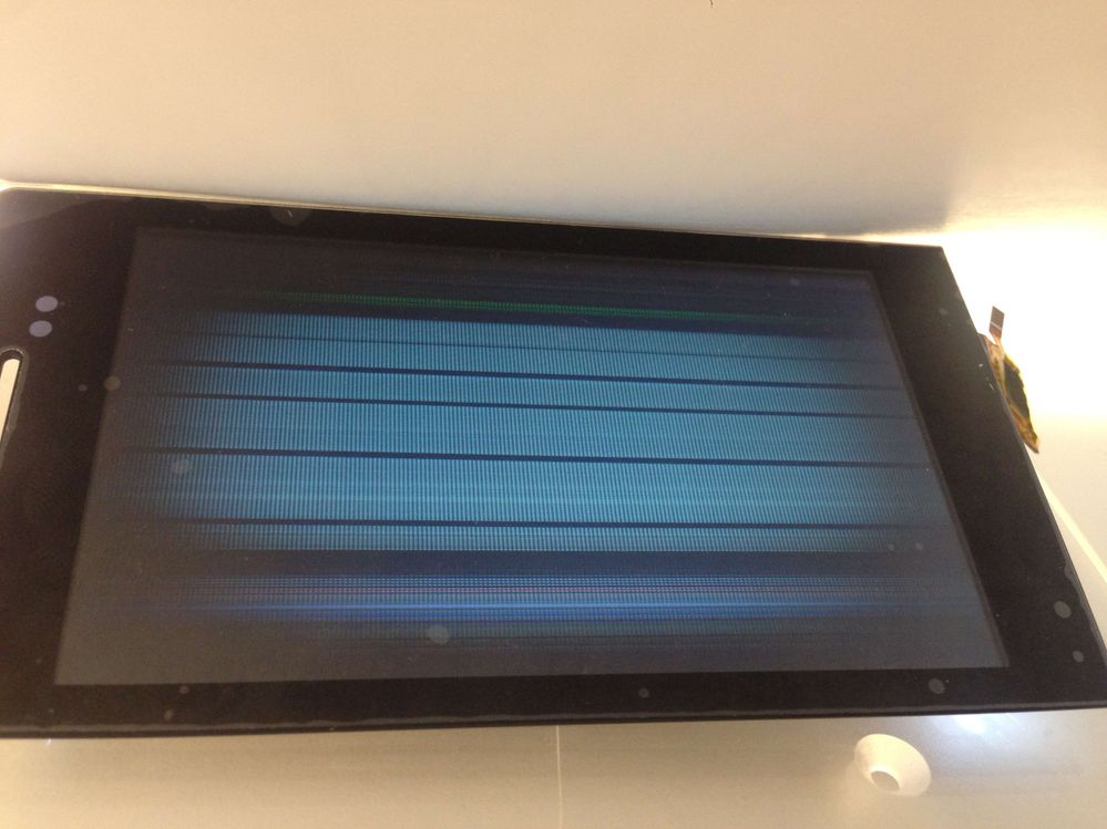

When Linux starts the driver is registered, but I cannot get a valid image,
 root@apalis-imx6:~# fbset -i
 mode "480x854-60"
     # 28.747 MHz, H: 53.039 kHz, V: 59.999 Hz
     geometry 480 854 480 864 32
     timings 34786 12 38 4 18 12 8
     rgba 8/16,8/8,8/0,8/24
 endmode
 Frame buffer device information:
     Name        : DISP3 BG - DI1
     Address     : 0x20800000
     Type        : PACKED PIXELS
     Visual      : TRUECOLOR
     XPanStep    : 1
     YPanStep    : 1
     YWrapStep   : 1
     LineLength  : 1920
     Accelerator : No
At linux boot the display image is
the LXDE desktop
and the command
gst-launch-1.0 -v videotestsrc ! imxg2dvideosink force-aspect-ratio=false
Anybody knows how to solve this?

igorpadykov
Hi Bastos
for new lcd its timings parameters should be entered in struct fb_videomode,
one can check example in linux/drivers/video/fbdev/mxc/ mxcfb_hx8369_wvga.c
Chapter 7 MIPI DSI Driver attached Linux Manual.
Also may be useful to check below patch
Patch to support MIPI display(hx8369) in uboot for i.mx6DL/DQ SebreSD boards
and try with nxp linux from codeaurora.org repository:
linux-imx - i.MX Linux kernel
igor
