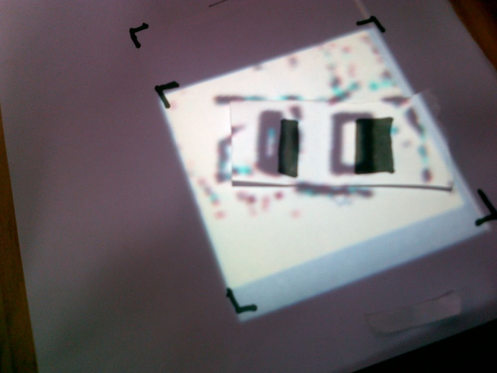

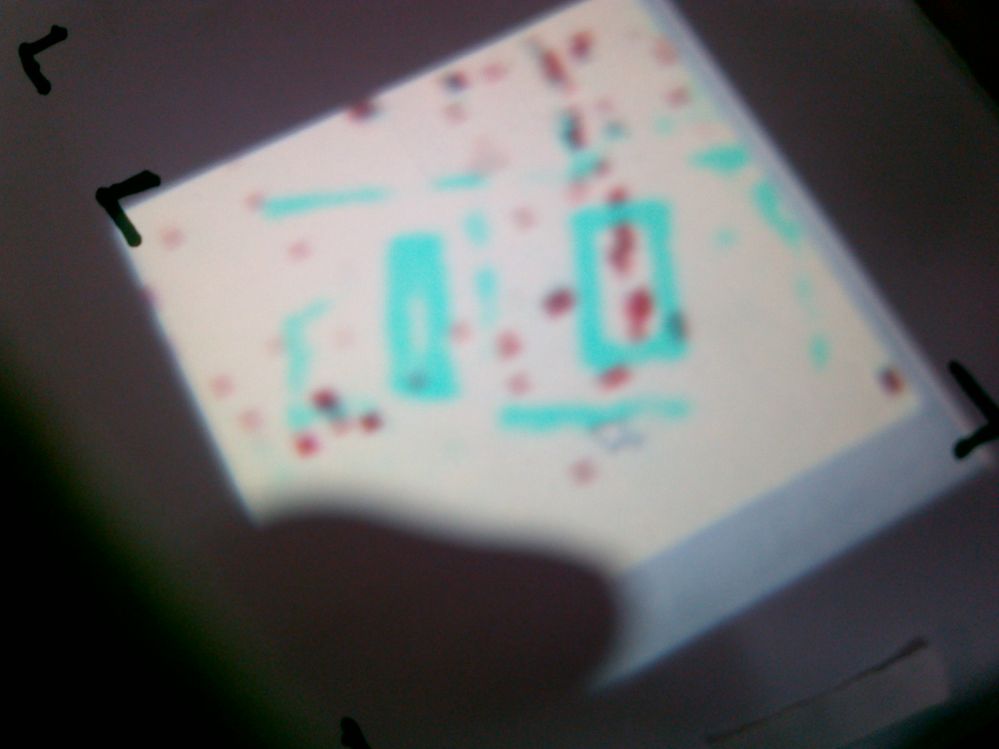

Hi all,
        Now I have made a project of Camera-Projection with i.MX6 quad, it can display now.
        However when display the real-time image from the camera, the early image will not clear until ~30 seconds,like following:
        1.I put a paper under the camera
2. When I move the paper, the image is still display
My projector parameters are as following:

What's the problem? What should I do?

For the settings seems ok your configuration but we need the datasheet for review pixel clock or the front and back porch,  I believe this is the problem.

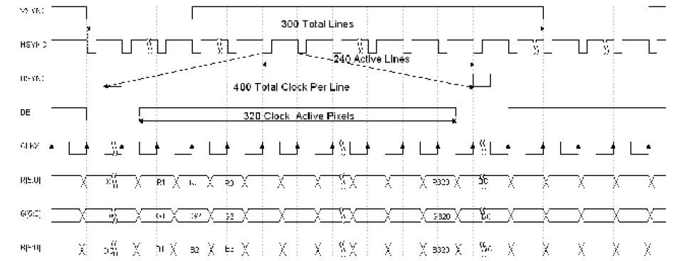

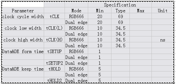

This projector only support DE mode, and the datasheet doesn't have the front and back porch, all specification is as following(the picture is cut from the datasheet, not scaled):
QVGA
Description               Min          Type            Max     Unit
Horizontal total         344           400              488     Pixel
Horizontal active        -               320             -          Pixel
Horizontal blank         -               80               -         Pixel
Vertical total             251           300             2000    line
Vertical active            -              240             -          line
Vertical blank             -              60              -          line
Frame Rate              -               120             -           Hz
Pixel clock              -                14.4M           -          Hz
The parameters from top to bottom are : VSYN, HSYN, (The parameter on original datasheet is not clear too,I can't recognize it),DE, CLK, R[5:0], G[5:0], B[5:0]

jamesbone
Seems correct your configuration, is the cable of the projector near to any electric source, that may cause  EMC or any other interference?
