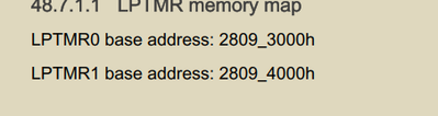

I would like to know the base register address of the generic timer in i.MX 8ULP.
In case of i.MX 8M Plus it is described in the reference manual as "System Counter_CTRL", but I am unable to find it in case of i.MX 8ULP.
I would appreciate any help about this.
Thank you.
1,636件の閲覧回数
pengyong_zhang
hi @NaKa85
I.MX8ULP does not have system Counter as same as i.MX8MP. Its call LPTMR on i.MX8ULP.please refer chapter 48 on i.MX8ULP RM. So it's base address is as follow:

NaKa85
Hi @pengyong_zhang,
Thank you for your reply and confirmation.
