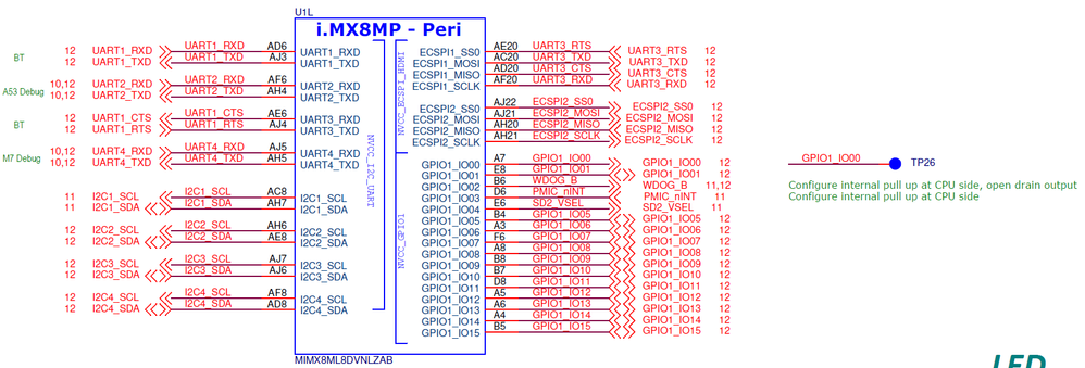

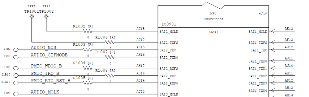

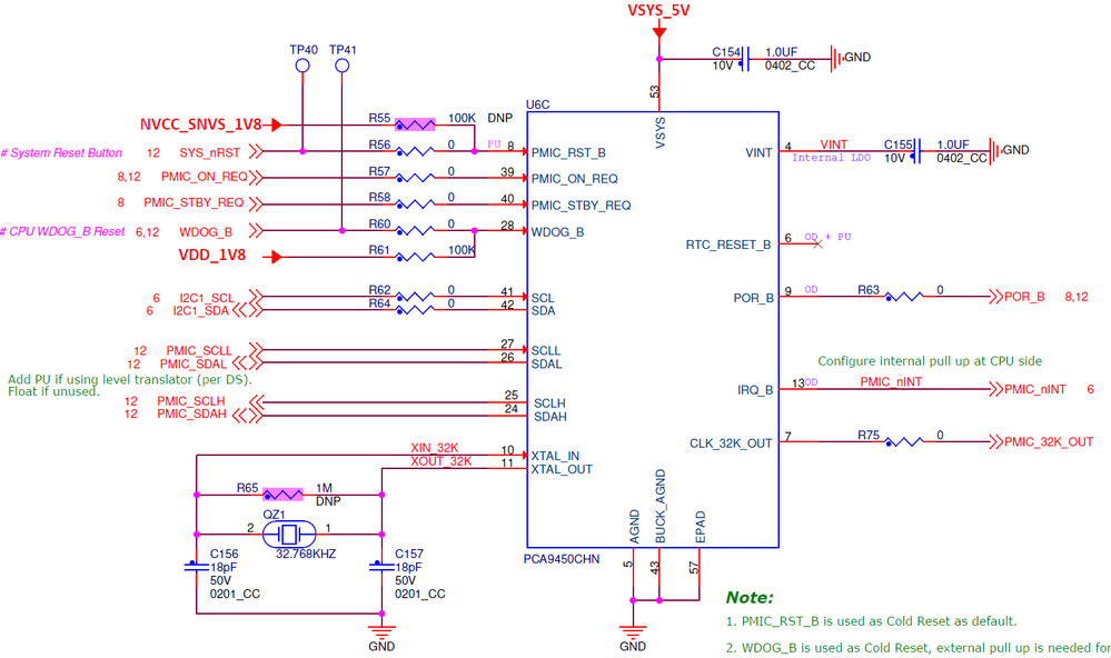

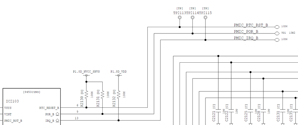

In my design, IMX8M Plus+PCA9450C+LPDDR4(refer to NXP EVK) is used.
Now , I want to reduce the working frequency of SOC and LPDDR4,
but the frequencis file is not visible with cat command, can not to be read and edited.
(If use NXP EVK, the frequencis file is visible with cat command, can be to read and edited.)
why is it,   can you tell me?
The difference between my design and the NXP EVK circuit is as follows.
NXP EVK: PCA9450C pin 13(IRQ_B) is connected to SoC pin D6(GPIO1_IO03)
My design: PCA9450C pin 13(IRQ_B) w/100k PU is connected to SoC pin AJ16(SAI2_RXC)
Note: The voltage of Soc SAI2 is design with 1.8V and connected to PCA9450C BUCK5.
Confirm it please.
Thanks a lot
