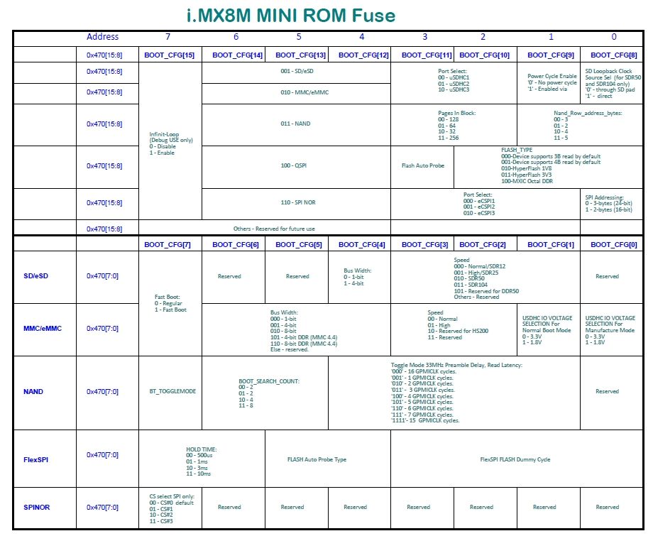

Could you please clarify the above items or at least give us a clear understanding of how exactly e.g. the imx8mm_evk could be fused to boot from its eMMC?
Anyway, our current fusing looks as follows but that does not quite seem to work as of yet:
fuse prog 1 3 0x100020d6 (BT_FUSE_SEL, eMMC boot, SD1, fast boot, 4-bit DDR, high speed, 1.8V)
fuse prog 2 2 0x00000001 (enable boot ack)
And the matching eMMC configuration:
mmc bootbus 0 1 0 2 (4-bit, reset bus width, DDR)
mmc partconf 0 1 1 0 (booting from boot area partition 1, send acknowledge)
BTW: That imx8mm_evk does not seem to connect the eMMC's reset aka RST# signal. Is that really recommended and has no adverse effect even considering eMMC fast boot spec actually requiring it?

The iMX 8M Mini application processor reference manual was used to look up the
meaning of the register definitions.
OCOTP_HW_OCOTP_BOOT_CFG0 register:
3035_0470 Value of OTP Bank1 Word3
Register fields defined on page 823 & p824
[15: 0] BOOT_CFG
   Page 816: Boot fusemap : eMMC
   [0] - IO voltage selection (Manufacture mode) : 0=3V3
   [1] - IO voltage selection (Normal boot mode) : 0=3V3
   [3:2] - Speed : 00=Normal
   [6:4] - Bus width : 010=8-bit
   [7] - Fast boot: 0=Regular
   [8] - SD loopback : 0=Through SD pad
   [9] - Power cycle : 0=Disable
   [11:10]- Port select : 10=uSDHC3
   [14:12]- Boot device select : 010=eMMC (According to p815, Table 6-41)
   [15] - Reserved

When u-boot is programmed into eMMC, it boots it regardless of the external bootpin settings.
If I wipe the u-boot from eMMC, it will load the u-boot on the SD card if the external boot pins are set to Mode0=1, Mode1=0
I expect the boot ROM is falling back to SD due to SDMMC_MFG (manufacture mode) still being active.

About eMMC fast boot on iMX8MMini_LPDDR4_EVK, I have a summary as following.
1.  Build boot image
Default release flash.bin can NOT support eMMC fast boot. Please rebuilt your flash.bin(boot image) using imx-mkimage tool.
~$ make SOC=iMX8MM flash_evk_emmc_fastboot
  Users can boot from SD fristly, then set eMMC configuration and burning boot image to eMMC correct partition.
2. U-boot command sets eMMC device configuration
eMMC number is 1 on iMX8MM_LPDDR4_EVK. IMX8MM fast configuration need to exactly match eMMC device side.
For example, if eMMC configs is "mmc1,fast_boot_ack_disable,boot0_partition" and  "mmc1,bus width is x04,ddr mode", GPIOs or efuse should be BOOT_CFG[7:0]= 11010111 and BOOT_CFG[15:8]= 00101010.
Users can try config BOOT_CFG under "internal boot" mode through GPIOs before fuse those bits.
All fast boot configuration except "ACK" could be set through BOOT_CFG. Fast boot "ACK" option only could be enabled by fuse, uboot command is "fuse prog 2 2 0x00000001"
To match the eMMC configs above, U-boot command should be
> mmc partconf 1 0 1 1   //mmc1,fast_boot_ack_disable,boot0_partition
> mmc bootbus 1 1 0 2   //mmc1,bus width is x04,ddr mode,high speed

If BOOT_MODE1 and BOOT_MODE0 be set as 00(BOOT From Fuses), boot config be read from efuse.
If BOOT_MODE1 and BOOT_MODE0 be set as 10(Internal Boot),  boot config be read from BOOT_CFG pins.
Table 6-43. MMC/eMMC Boot Fusemap
=> Does the "Power Cycle Enable" and/or "SD Loopback Clock Source SEL" settings actually really matter at all if booting from eMMC?
Both configs have effect on eMMC booting.
BOOT_CFG[9]"Power Cycle Enable" determines SD power cycle enable/eMMC reset enable;
If the SD Loopback Clock is set, the feedback clock comes directly from the loopback SD clock, instead of the card clock(by default).
=> Row 0x470[7:0] mentions "Reserved for HS200". Is HS200 actually supported for eMMC booting at all?
"Reserved for HS200" means current boot code can NOT support HS200 mode.

=> That graphic show 5 BOOT_CFGs, however, it is not quite clear what exactly is meant by those.
List all fuse shadow memory, BOOT_CFGs[0:4], Shadowed memory mapped access to OTP Bank x, word x.

=> At least here there is the first concrete mentioning if OTP banks and words but what exactly they map to now is still not quite clear e.g.
For fuse mapping, please refer to Table 6-43. MMC/eMMC Boot Fusemap and Table 6-47. Boot Fusemap.
Value of OTP Bank1 Word3 (Boot Configuration Info.) (OCOTP_HW_OCOTP_BOOT_CFG0)
Address: 3035_0000h base + 470h offset = 3035_0470h
Value of OTP Bank2 Word0 (Boot Configuration Info.) (OCOTP_HW_OCOTP_BOOT_CFG1)
Address: 3035_0000h base + 480h offset = 3035_0480h
Value of OTP Bank2 Word1 (Boot Configuration Info.) (OCOTP_HW_OCOTP_BOOT_CFG2)
Address: 3035_0000h base + 490h offset = 3035_0490h
Value of OTP Bank2 Word2 (Boot Configuration Info.) (OCOTP_HW_OCOTP_BOOT_CFG3)
Address: 3035_0000h base + 4A0h offset = 3035_04A0h
Value of OTP Bank2 Word3 (BOOT Configuration Info.) (OCOTP_HW_OCOTP_BOOT_CFG4)
Address: 3035_0000h base + 4B0h offset = 3035_04B0h
