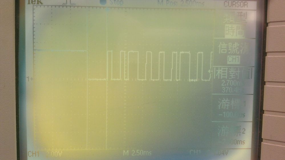

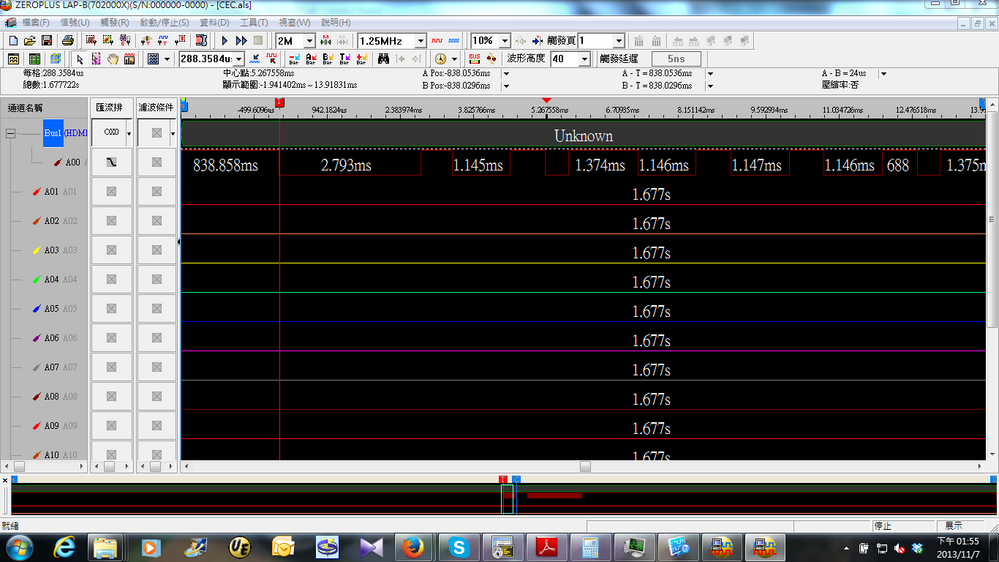

And I found the CEC waveform not match HDMI-CEC spec. The HDMI CEC spec describe the start bit must be 3.5 ~ 3.9 ms . But we are only 2.793 ms.
6,067 Views
qiang_li-mpu_se
Hi Jimmy, did you measure it on SabreSD or customer's board?
From HDMI side, I haven't found any setting to adjust this timing.

qiang_li-mpu_se
Hi Jimmy, on SabreSD, we had measured the CEC signal, the start bit is about 3.6ms, which board are you used for the test?
Can you attach detail waveform?
6,066 Views
weikeng-jimmy
My BSP is Linux version L3.0.35_4.1.0 And test platform is Sabre-SD board.
The attach file is waveform for first command.   --> Try to get CEC Version !IMAG0444.jpg
