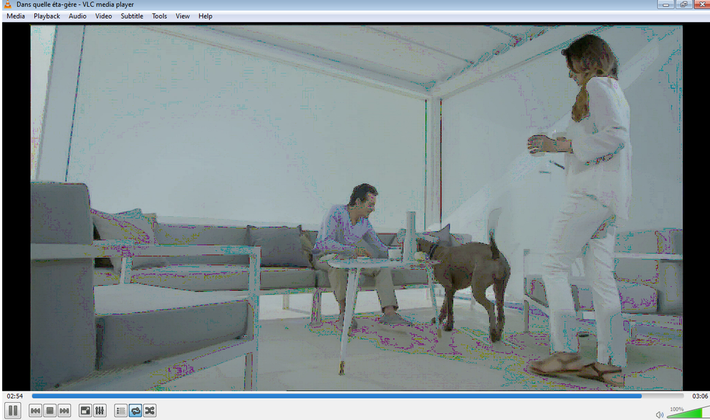

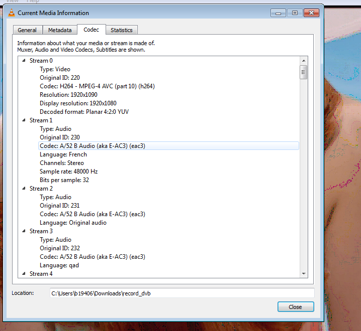

Only to make sure I'm seeing the same movie you are. Using VLC (Win7 PC) I have a lot of artifact:
I have tons of audio streams. I'm assuming the target one is the stream 1. I must double check if this specific coded is supported by the BSP you've been using.
I'm going to contact the internal team in order to verify the codec, and I should update you at the end of my day or (worst case) tomorrow, regarding the status of this issue
