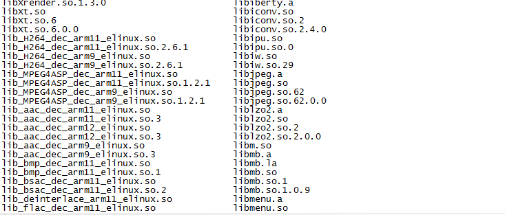

i  compile ltib add gst-plugins-good but i cant get jpegenc
and my lib have libjpeg.so
how to get jpegenc ,thanks

igorpadykov
ltib provides separate codecs package which includes jpegenc
please check fsl-mm-codeclib-1.7.1 on
Codecs and other Algorithms (1)
Linux Multimedia Codecs source code and deb install packages
(Gstreamer package and OpenMax packages)
i.MX51 Evaluation Kit|NXP

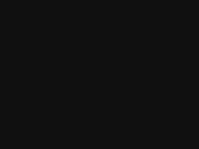

陈万里
gst-launch v4l2src num-buffers=1 !  video/x-raw-yuv ! queue ! ffmpegcolorspace ! queue ! jpegenc ! filesink location="sss.jpeg"

Yuri
  Looks like You are using USB camera (v4l2src).
Is Your video dev number (X) correct (/dev/videoX) ?
Is it possible to get any image from the camera ?
Yuri.
