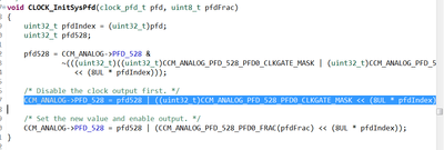

Can I use flexspi driver provided in MCUXpresso with the RTOS application?
I am running evkmimxrt1020_lwip_tcpecho_freertos example code with evk-1020 board. But when I add the flexspi driver with the project and try to initialize the flexspi_nor_flash_init, the code is stuck in the following marked line. Is there any example code available where flexspi is used with TCP/IP stack in an RTOS environment?

1)Is there any example code available where flexspi is used with TCP/IP stack in an RTOS environment?
-- The above issue is related to the FlexSPI driver, I guess you forgot to relocate the driver into the RAM, so to provide the fastest possible support, I'd like to suggest you refer to the freertos_hello_flash_operation which resides in ~\boards\evkmimxrt1020\rtos_examples of SDK library
