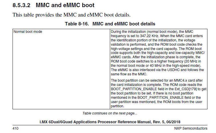

been reading a bit in the hw ref on how to configure fastboot (in my case, i.mx8 mini + eMMC only, no separate spi flash)
anyone that can help clarify
- what exactly is the difference between "normal" emmc boot vs "fast boot"?
- any relative number in terms of the diff in speed between the two?

for differencies one can check sect.10.3.3.9 MMC fast boot
i.MX 8M Mini Applications Processor Reference Manual
Unfortunately I am not aware of fast boot times.
igor

I've read the TRM section, no real details on the benefit of fast boot, other than the fact that it's called "fast" :-)
Since there is a bit of work to prepare for "fast-boot", I was curious to know if anyone had an idea of how much time is saved by this method.
ps. I like 'uuu' and seems it's not supported as fastboot needs some hard offsets. Any plans to change this?
