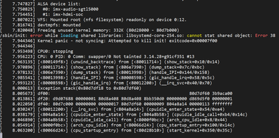

error while loading shared libraries: libsystemd-core-254.so
1,416件の閲覧回数
deepi
I used yocto to build the root file system of imx6dl with the command "bitbake imx-image-full", but encountered an error during system startup
how should I solve this problem
ラベル(2)
1 返信
1,392件の閲覧回数
Bio_TICFSL
In this case you have to build again the entire yocto project and erase everything before building.
