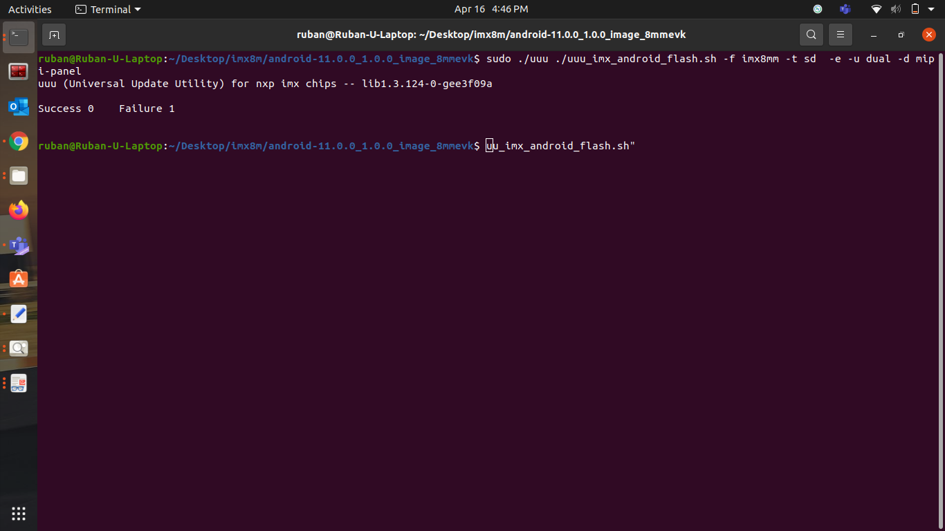

error flashing Android BSP using uuu through port1
1:3       1/2 [Can find validate IVT header                    ] SDP: boot -f "./uuu_imx_android_flash.sh"
3,534 Views
AldoG
For android flash using UUU you'll only need to run the script provided in the prebuilt package, please try with the following command:
$ sudo ./uuu_imx_android_flash.sh -f imx8mm -t sd -e -u dual -d mipi
