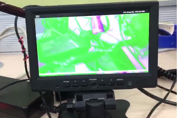

petersonhou
kernel version:
Linux imx8qxpmek 4.14.98-06466-g5910884-dirty #99 SMP PREEMPT Thu Feb 27 23:43:30 PST 2020 aarch64 aarch64 aarch64 GNU/Linux
 Galcore version 6.2.4.190076
The UART still output
ES30: some draw get error and skipped during validation
and the LCD display like blew:pastedImage_4.png
and flicker
Looking forward your answer!Thank you!
