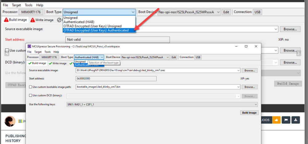

I have MIMXRT1170-EVK. i build some application using IAR. XIP: no, start from RAM. Then i run MCUXpresso Secure Provisioning, generate keys, choose boot type as Authenticated (HAB) and  build bootable image. I get signed image and that's fine and works well. But there is one strange thing. As long as i use external flash in addition to signing  i want to encrypt my image. And i can't figure out how to do it.
I went through a pile of documents and found only that i must use dek.bin and then write down it in SEC_CSF_INSTALL_SECRET_KEY section in *.bd file. And it's says "it is random generated automatically by the HAB encrypted tool". But there isn't any dek file.
Well, I'm obviously doing something wrong. What?
And I have a really big favor to ask. Please, do not send me just a links to manuals. I went deep diving through manuals. Just point me in right direction in simple terms and i will try to dig out the rest.
Thank you

After implementing the HAB secured boot, it seems that you want to encrypt the image, and the application runs in the RAM, is my understanding right?
If yes, the RT117x hasn't supported this boot mode.

Yes, You're absolutely right. But it's a catastrophe for me. How, in this case, can i protect my image storing in external flash?
Can i encrypt my image in case of XIP?
Sorry, but i am blown away right now.

1) Can I encrypt my image in case of XIP?
-- Yes, and I also recommend you to do that, and Encrypt XIP mode is available to combine the HAB boot feature adds security level.
Moreover, it's easy to do it via the MCUXpresso Secure Provisioning tool.

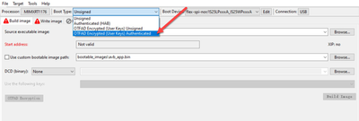

solted_squid
Your picture certainly looks good but my picture is quite different

jeremyzhou
Thanks for your reply.
Please update MCUXpresso Secure Provisioning to the latest version, then give it a try again.
