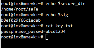

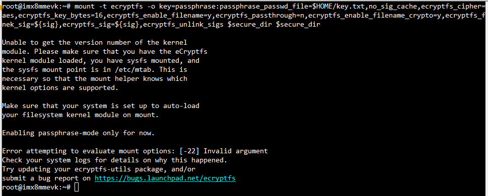

I am trying to using encrypts for encrypted storage on imx8m mini.
I am using kernel 5.4.24.
when I try to mount, I get the below error
below are the shell variables that are used in the above command
Please suggest.

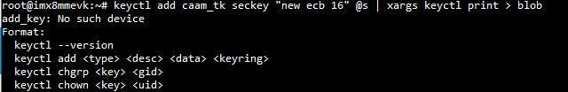

for encrypted storage usage one can look at AN12714
i.MX Encrypted Storage Using CAAM Secure Keys

john_wick
Hi igor,
Thanks for your response. I have tried that. But it didn't work for me.
I was referring to AN12714 Rev0. I get the below error while trying to generate keys.thumbnail_image.pngthumbnail_image.png
I have attached list of my kernel modules for reference. I did search for this error, but in the forum, lot of people suggested to upgrade 5.4.47 kernel for this to work. Please confirm.

john_wick
Also, for the actual question I posted regarding ecryptfs error, the problem was the kernel module for ecryptfs was not set.
After setting, CONFIG_ECRYPT_FS=y, it started working as expected.
However, Igor, I would like to know the solution for the below error regarding dm-setup process as mentioned in AN12714.
Thanks in Advance
