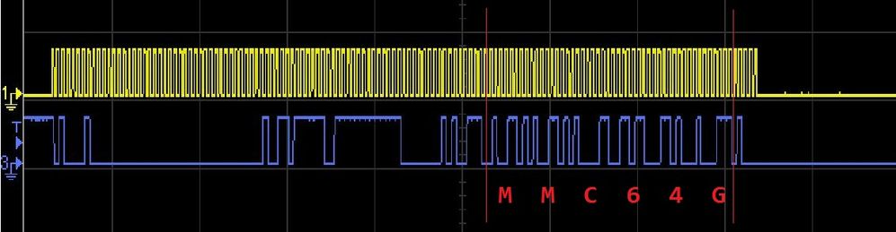

Hello!
Is it possible to boot IMX6Q from Micron 64G eMMC 4.41 card (MTFC64GJDDN-4M IT)?
Boot process stops every time after reading Product name from CID Register (as a response on CMD2). A few microseconds after the eMMC card sends "MMC64G" string, CMD and CLK lines go LOW (as you can see in the picture below, 1 - CLK, 3 - CMD).
Are there any restrictions on size of the card? If no, what else can cause the problem?

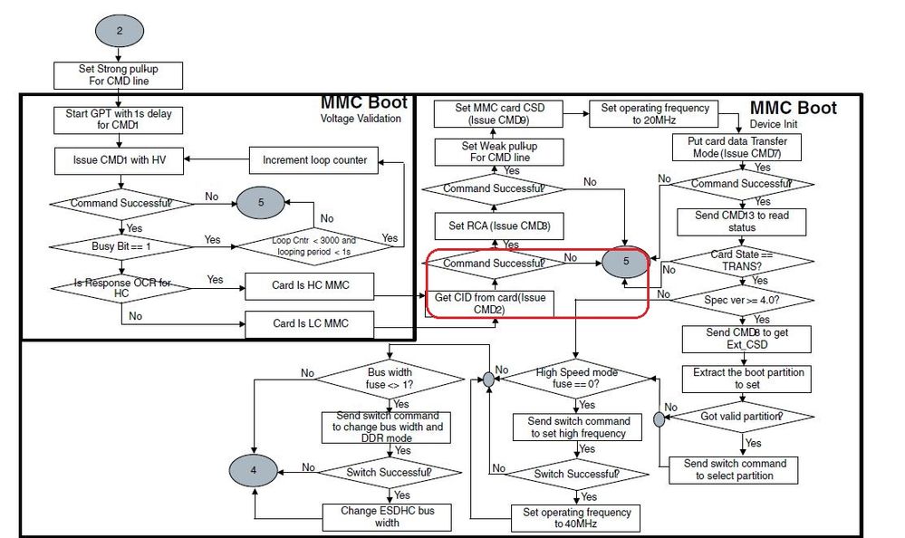

Is it possible that BootROM reads Product name, compares it with some not known for us value and based on the comparison result decides to stop booting process?
Is there any way to get BootROM source code?
Our board revision is 1.3 so that is not ERR006282.
6,922 Views
igorpadykov
No.
Unfortunatly BootROM source code is not distrubuted, sorry.
igor

I forgot to mention, that our card works perfectly normal when we are accessing it from u-boot or Linux, it has problems only while booting.

igorpadykov
you can change IOMUX settings used by BootROM using
Table 8-14. USDHC Boot eFUSE Descriptions
BOOT_CFG2[0]  - 1 - Use PAD_SETTINGS values
check PAD_SETTINGS in Table 8-2. Boot eFUSE Descriptions
i.MX6DQ Reference Manual
http://cache.freescale.com/files/32bit/doc/ref_manual/IMX6DQRM.pdf

We have checked that our eMMC card works fine in u-boot with default IOMUX settings (IOMUXC_SW_PAD_CTL_PAD_SD4_CMD - 0x1B0B0, IOMUXC_SW_PAD_CTL_PAD_SD4_CMD - 0x1B0B0). It can even respond properly on CMD2. So I guess we can assume, that it should works with default IOMUX settings in boot process. Am I right?
In addition, in the picture which I've attached earlier you can see, that the CLK line suddenly goes LOW. Since it is INPUT for eMMC card, I guess only IMX6 can hold it LOW. But why?

I have no possibility to check other emmc cards, I am referring only to SDIN5C2-8G which is used on SABRE SD and works fine. I can compare signals on CMD line and can say that there are 2 difference:
1) on Sabre SD there are less CMD1 commands, so the Initialization process takes less time
2) on Sabre SD CMD2 ends properly
Are there any restricions on one command duration time? Maybe it is some timeout while sending CMD2 (it ends always after ~404us).
