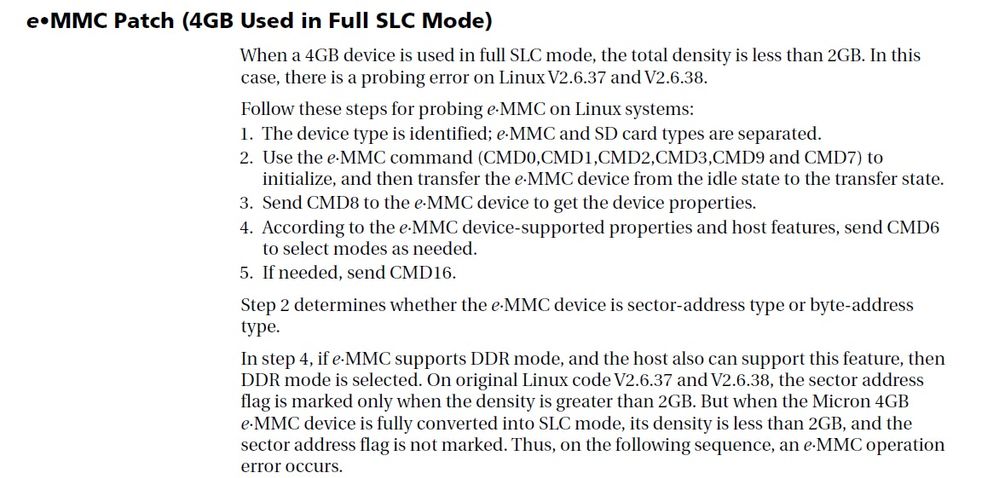

As I remember Micron eMMC has SLC mode function.
You can download document from  https://www.micron.com/-/media/documents/products/technical%20note/emmc/tn5205_emmc_linux_enablement...
If you enable SLC mode , you can't change to MLC mode. (Like OTP function)
