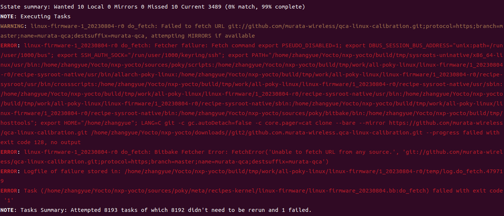

Demon
I have already download the qca-linux pack and put it into download ,but the error still happen.
And I can't find the linux-firmware-1_20230804-r0 .
how to solve it .

Harvey021
Have you also made a copy for the qca-linux pack at the downloads directory, like, xxx.done?
Harvey
